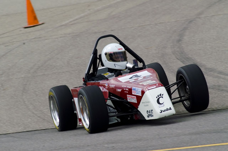

How many teams broke stuff at the transition on to the banking in endurance?
We broke the right steering arm and I've heard of at least two other teams breaking steering components there.

we didn't break anything but I was standing there to take photo at the time and it looks pretty scary for the cars coming onto the banking....

We didn't break anything but as you can see from the pic above the car was very unsettled. I was taking it very gently over the transition, the car would get upset, stomp on the gas to settle the rear, and hold on. The guys from UWA got a laugh from me afterwards when we were discussing it. With a sly little grin Pete goes, "What bumps? I didn't feel any bumps."

There were two sections that occurred on the banking. The first was the left hander picture above. It completely crossed onto the banking, so there was no way to above it completely. The other section was the pass zone; it was fine.

That left hander into the banked section is what buckled our rear right pushrod during my last few laps before the driver change. I was able to nurse the car around the track for the driver change, but 3-4 laps after our second driver was in, we got meatballed for dragging the body and lifting wheels.
I saw a picture of RMIT similar to the picture of Cincinnati above where at that transition they had their front left wheel a good 2-3 inches off of the ground!
