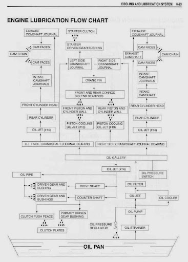

quote:
Originally posted by Jan_Dressler:
Hi dazz,
"The space is there".. Brings back horror... Believe me, the space will not be there - not enough. Been there, done that. "snip"
The SV isn't as bad as the Honda looks to be:
- Gearbox needs a supply to the centre of input and output shafts and to a spray rail, all from the same side of the case, and quite close to each other.
- Engine needs supply to the two main bearings (crank big ends are fed from these also), 2 piston cooling jets, and a single supply to each head.
- A multistage dry sump pump built into the bottom of the engine cases opposite the starter motor would scavenge the crank case, and the left and right heads, probably via external lines.
I'm not saying it's a 5 min job, I would have already done it if that was the case, and I reckon that there's probably a similar amount of time required to what I've already put into the project to work out all the small details.
For reference, the SV manual is pretty nicely detailed as you can see below.
Posts: 86 | Location: Deakin,VIC,Australia | Registered: May 30, 2008Reply With QuoteReport This Post
